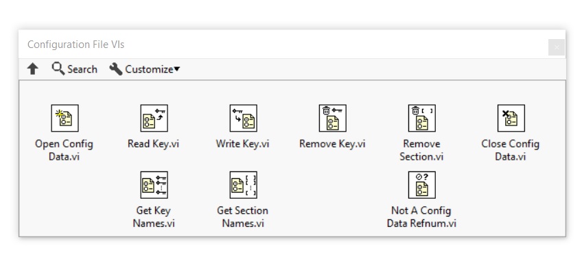

I am communicating with another device using EtherNET/IP via an EDS file. How do I interact with an EDS file from within LabVIEW?
You can use the Configuration File Library in the File I/O palette in LabVIEW to interact with an EDS file.
