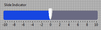

Slide indicators fill from the left side by default, as shown in the image below.
There are several other fill options such as "Fill to Maximum" but how do I fill the slider from 0 instead of the left side?
