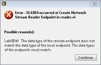

I am trying to pass data via network streams. I don't get any build errors but when I run my code I get error -314304, as shown below:
Network streams do not support enums, numerics with units, subarrays and substrings. Defining a network stream endpoint with one of these data types will cause this error. There are ways of working around this problem as described below.
