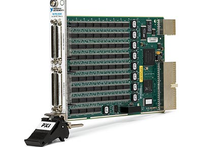

A PXI Card with a Standard Connector - Can be Used to Control SCXI
A PXI Card with a Hybrid Connector - Cannot be Used to Control SCXI
A PXIe Card with an Express Connector - Cannot be Used to Control SCXI
PXI M Series with the hybrid connector began shipping on 2/28/2006, so boards received before this time will be able to control SCXI in a Combination Chassis. If there are doubts as to which version you have, the hybrid connector has a gap in it, while the version that can control SCXI does not, and has a full backplane connector.
