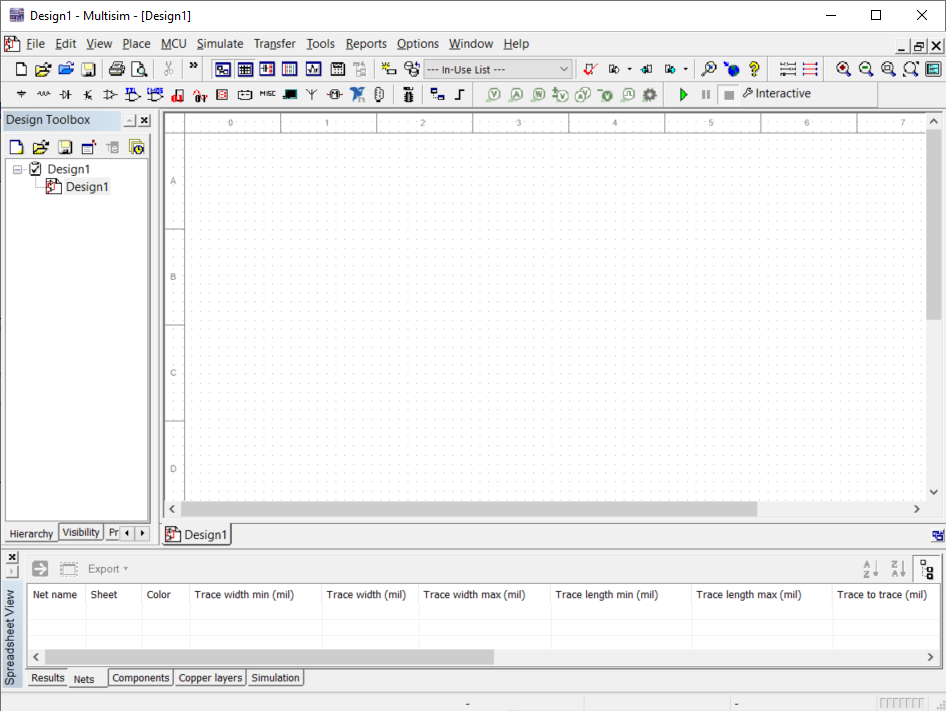

I can't find the Instruments Toolbar in Multisim. How can I add it to my window?

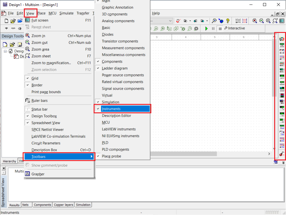

To add the Instruments Toolbar to Multisim window, follow these steps:
  1. Open Multisim.
  2. Go to View.
  3. Click on Toolbars.
  4. Mark the option: Instruments.
  5. It will appear on the right of the window.
