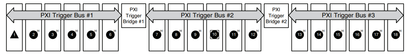

If this method fails, there are a handful of considerations that can be made:
  • Do RFSA Soft Front Panels allow you to associate the devices? If so, your LabVIEW code may be incorrect.
  • Do both the downconverter and digitizer pass a MAX self-test? If not, the failing card may be damaged or require individual troubleshooting.
  • Are the components of the 5660 connected as documented in the PXI-5660 Getting Started Guide ?
    • Are cables torqued to spec and undamaged? Try swapping cables if possible.
    • Is the 10MHz ClkOut port of the PXI-5600 outputting a correct 10MHz clock? Use a scope to confirm that a proper clock is being distributed.
  • Are the 5600 and 5620 located on the same PXI Trigger Bus?
    • If not, use the Chassis Trigger Routing tab in MAX to reserve trig lines between the buses of the cards
    • If trigger routing doesn't work, try moving the cards onto the same bus to test.
