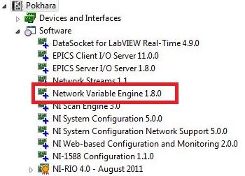

- Make sure that the Network Variable Engine software is installed on your Real-Time target. In order to check whether or not this software is installed, locate the Real-Time target in NI Measurement & Automation Explorer (NI MAX), then expand the Software list.
If it is installed you should see
Network Variable Engine as seen above. This is the engine that is referred to as the
Shared Variable Engine in the error message.
If the engine is not present and you need to install it, follow these steps:
1. Right-click on Software and select Add/Remove Software.
2. Select the LabVIEW Real-Time Software and then select Next.
3. Check the box next to Network Variable Engine and select Next.
4. Select Next again to review the configuration and the software will be loaded onto the Real-Time target.
