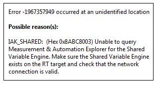

  • I am trying to deploy shared variables to my Real-Time target and I get the following error.
  • I am trying to undeploy a shared variable or library from my Real-Time target in NI Distributed System Manager (DSM) and I get the following error.
  • I have changed subnetwork for both PC and sbRIO and running created .exe file same error occurs.
Error -1967357949 occurred at an unidentified location. Possible reason(s): Unable to query Measurement & Automation Explorer for the Network Variable Engine

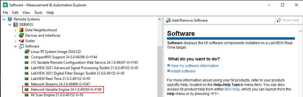

  • Make sure that the Network Variable Engine software is installed on your Real-Time target. In order to check whether or not this software is installed, locate the Real-Time target in NI Measurement & Automation Explorer (MAX), then expand the Software list.
If it is installed you should see Network Variable Engine as seen above.  This is the engine that is referred to as the Shared Variable Engine in the error message.

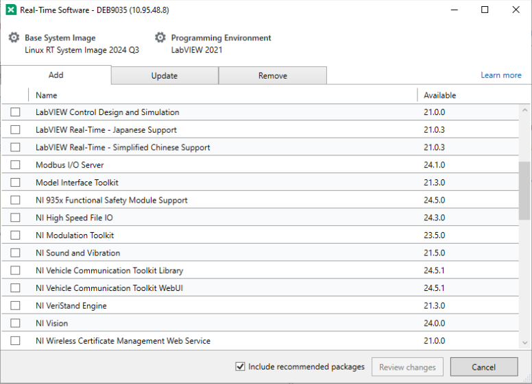

If the engine is not present and you need to install it, follow these steps:
1. Right-click on Software and select Add/Remove Software.
2. Check the box next to Network Variable Engine in the Add tab and select Review Changes.
3. Review the configuration and click Continue and the software will be loaded onto the Real-Time target.
