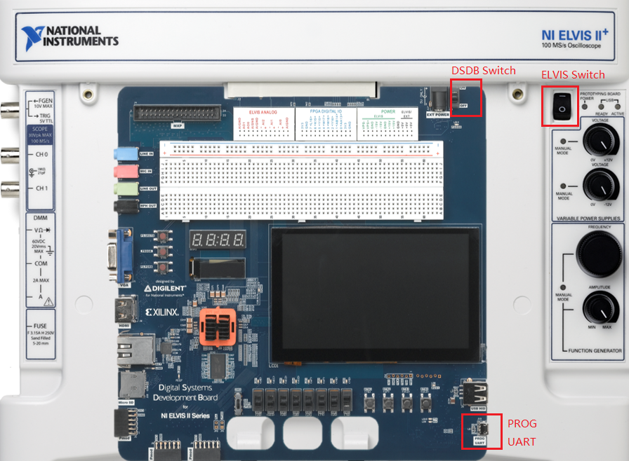

  2. Check the hardware connection of ELVIS and DSDB.
  • Check if the ELVIS power cable is connected to the power supply interface and whether the USB data cable is properly connected to the PC.
  • Check if the UART interface on the DSDB board is connected to the PC USB interface.
  • Check if the power switches on the ELVIS and DSDB board are turned on separately.
The UART interface on DSDB and power switches of DSDB and ELVIS are all marked in the figure below.
