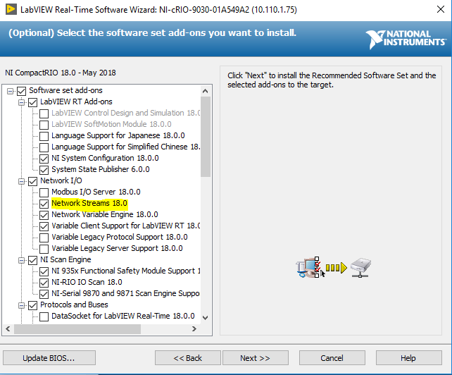

I am trying to stream data using Network Streams between my PC and my CompactRIO but the connection is not working. How can I troubleshoot this issue?
Network Stream communication can be inhibited for many reasons. Check the list below to address common reasons for Streams between PC and CompactRIO not working.
  • Make sure you have Labview Real-Time Module installed in your host Computer , otherwise you will not be able to install Network streams on your cRIO
  • Check that the Network Stream support is installed in the cRIO in NI Measurement and Automation Explorer (MAX) by looking in the software list under Remote Systems >> <cRIO hardware> >> Software.
    • If is not installed, install it from MAX.
