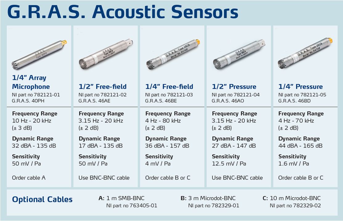

NI has partnered with G.R.A.S. to provide an array of microphone and preamplifier options that have certified compatibility with the NI Sounds and Vibration Hardware like the NI 9234. The microphones integrate Transducer Electronic Data Sheet (TEDS) chips and use IEPE signal conditioning from the NI 9234. Visit the G.R.A.S. Selection Guide page for information on how to determine which microphone to select for your application.
