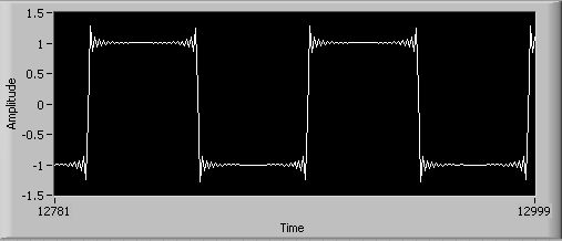

I am trying to input or output an impulse or waveform with sharp edges (Square, Triangle, Sawtooth, etc.) from my Dynamic Signal Acquisition (DSA) device. I am seeing an unexpected response, unwanted noise, distortion, ringing, pre-ringing, spikes, ripples, transients, or oscillation. Why is this and is there any way to prevent it?
This response is due to ringing artifacts from the interpolation filters necessary to perform the Delta-Sigma modulation. This usually appears as an overshoot and then a settling time, also described as rounding after an instantaneous change occurs, such as the rising or falling edge of a square wave.
An example of this response is shown below:

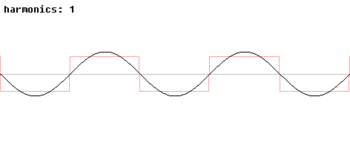

Mathematically, this can be described as Gibbs Phenomenon, which is the result of an instantaneous change to a system with a finite number of samples. A pure sine wave has only a single fundamental frequency and no higher-order harmonics. A square wave has an infinite number of frequency components. A sine wave can be transformed into a square wave by adding harmonics to its fundamental. As such, an infinite number of harmonics will produce a perfect square wave. However, if the bandwidth of the system is limited, as is the case with all discrete devices, some harmonics will not be present in the signal; thus, distortion of the waveform occurs.
The use of harmonics to build a square wave is demonstrated in the figure below:
