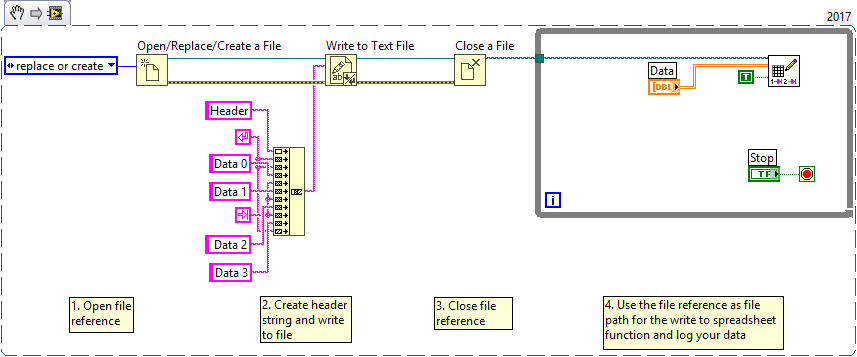

I want to create a spreadsheet file on LabVIEW that would include column headers similar to what can be done on a text file.
How do I proceed?
Writing headers on Spreadsheet files is not natively supported by the LabVIEW function Write to Spreadsheet File. To do so, you need to open a file reference and write your headers, similar to what can be done for a text file. After closing the file reference, you should then move this reference as a file path to the "Write to Spreadsheet file" function along with the data you want to log in the Spreadsheet file.
The code describing this workaround should look like this, as shown in the following snippet:
code snippet
If you import the generated file into Microsoft Excel, you will be able to generate a table with the correct headers, as shown in the image below.
