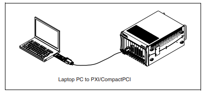

There is not a single MXI-Express kit that will allow you to control a PXI chassis through both ExpressCard on a laptop and PCIe card on a PC. Through the correct combination of components, it is possible to remotely control a PXI chassis using both a PC and a laptop without the need to buy both of the complete MXI-Express kits. An NI ExpressCard MXI system consists of an NI ExpressCard-8360 in a laptop PC connected to an NI PXI-8360 or NI PXIe-8360 in the controller slot of a PXI/cPCI or PXIe/cPCIe chassis respectively, as shown in follows:

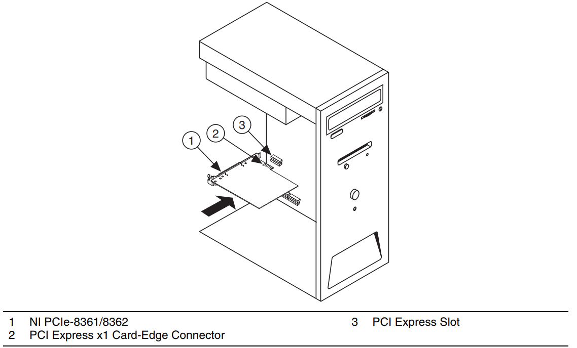

The following are general instructions for installing the MXI-Express x1 cards. The same procedure applies for a PCI card and slot.

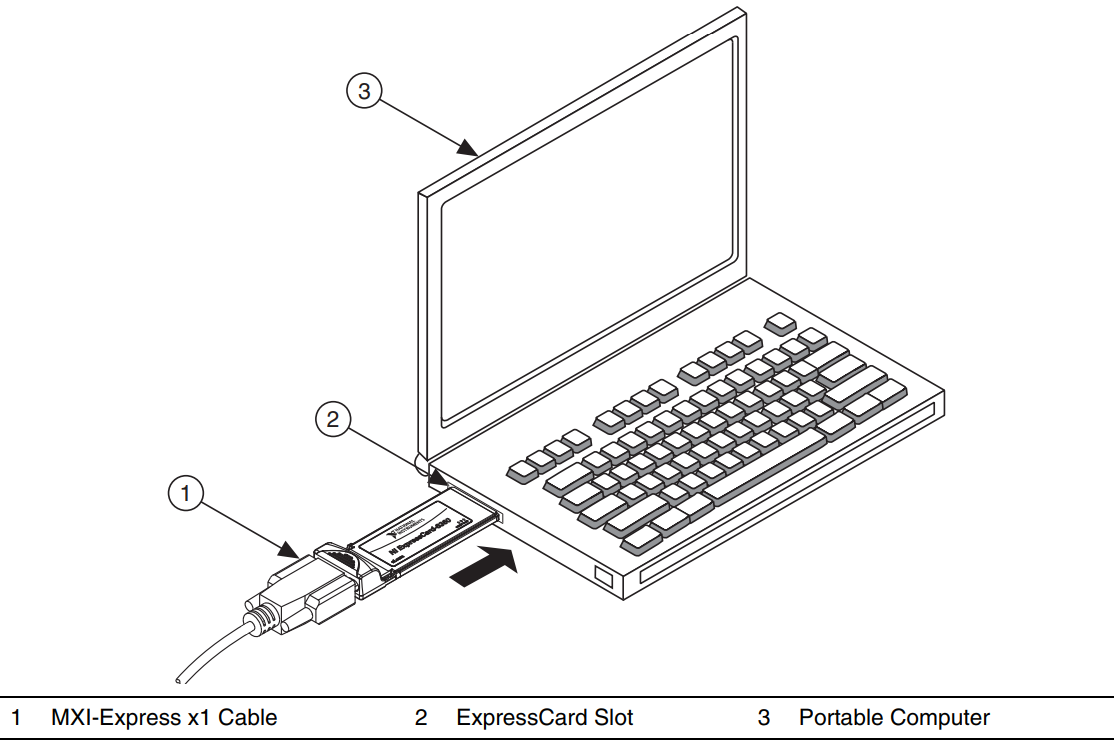

The following graph  shows how to insert the NI ExpressCard-8360 into a laptop and connect the cable.

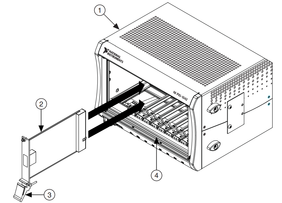

The following graph shows how to install the NI PXI board into your PXI or PXI Express chassis

  • NI PCIe 8361 (The interface card which slots into the PC)
  • NI ExpressCard 8360 (The interface card which slots into the laptop)
