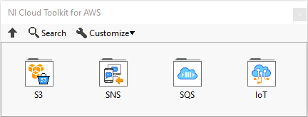

  • LabVIEW Cloud Toolkit for AWS provides support for AWS services such as S3, SNS, SQS & IoT.
