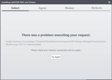

  • I am trying to install LabVIEW for the first time. The installation is getting to the “Installing LabVIEW NXG and Drivers” and is falling. After selecting Next the following screen appears:
In order to download and install LabVIEW NXG it is necessary to first have NI Package Manager installed on the computer. There are two ways to get LabVIEW NXG installed:

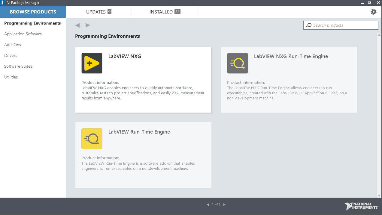

  1. Download NI Package Manager and manually select LabVIEW NXG to be installed:
1) Download NI Package Manager
2) Select LabVIEW NXG
There is no installation file for LabVIEW NXG. The installer is downloaded from NI Package manager. There is an executable that partially installs NI Package Manager and starts to download and install LabVIEW NXG.
