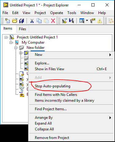

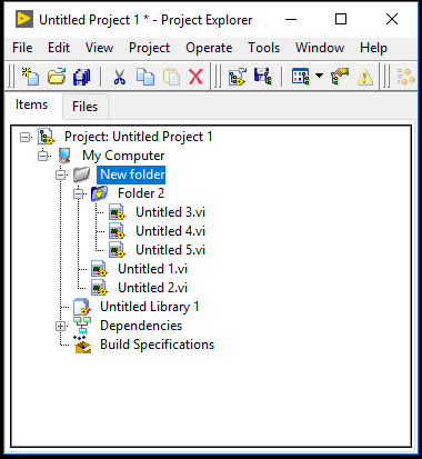

Currently there isn't a method to directly rename the auto populating folder without breaking the dependencies within the file path. However, there are a couple of methods you could take to workaround this issue.
The First Method uses the following steps:
- Create a new folder with the name you need.
- Stop auto populating the original file folder before moving it to a new folder with the correct name.
- Add either the file that houses the dependent files (Folder 2) or the VI's from within that folder and add them directly to the new file.
![](/servlet/rtaImage?eid=ka03q0000012mt0&feoid=00N0Z00000HEWRt&refid=0EM0Z000000p6lI)
![](/servlet/rtaImage?eid=ka03q0000012mt0&feoid=00N0Z00000HEWRt&refid=0EM0Z000000p6lN)
After following this procedure, you could then convert the folder back to an auto populating folder.
