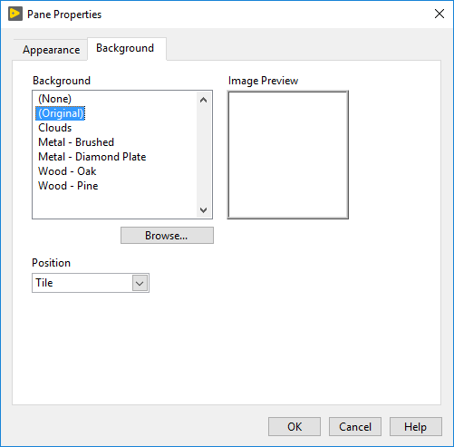

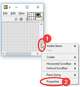

  1. Right-click a scrollbar of the Front Panel and select Properties from the context menu to open the Pane Properties dialog box.

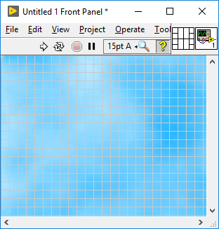

  1. Activate the Background tab. Now either select one of the shipped images listed in the Background listbox, or click Browse to pick an image stored on your computer, adding it to the Background listbox temporarily.
  1. Click OK to close the dialog box and apply the image.
