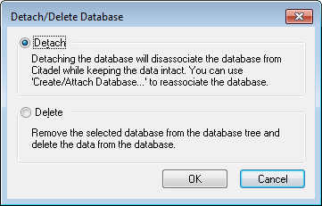

 - Navigate to your Citadel database in NI MAX.
 - Right-click on your database >> Detach/Delete...
- In the dialog that comes up select Detach and click OK.
- The database is now detached.

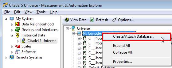

 - Open NI MAX on your destination computer >> My System >> Historical Data >> Citadel 5 Universe
 - Right-click on My Computer under Universe and select Create/Attach Database...

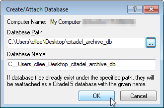

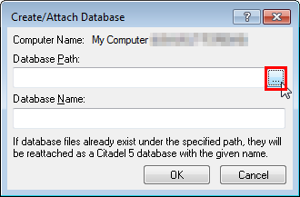

- A window should pop up.  Click on the ... to browse for the path of your database.
- Select your database folder and click OK
- Check to make sure your path is correct and select OK

- In NI MAX of the computer you want to copy your database to, navigate to My System >> Historical Data >> Citadel 5 Universe.
 - Right-click on My System on the right panel >> Create/Attach Database...

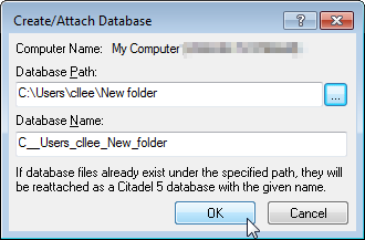

- A window should pop up.  Click on the ... to browse for the path of where you want the database to be copied.
- Select the folder where you want the database to be copied or create a new folder and click OK.

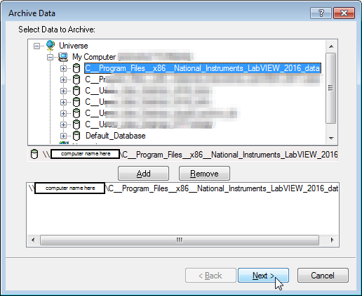

- In NI MAX, navigate to your Citadel database that you want to export.
 - Right-click on your database >> Archive...
- Select the database(s) that you want to archive and click Next.  You can choose which ones you want to archive by using the Add and Remove buttons.  Check the bottom window to make sure you have all and only the databases you want archived selected.
- Go to Universe >> Network and find the computer you want to archive your database(s) to.  Select the database and click Next.
