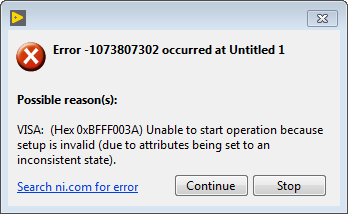

I am currently communicating with an Ethernet serial instrument. When I request the instrument’s status byte, the VISA Read STB function throws Error -1073807302:
VISA: (Hex 0xBFFF003A) Unable to start operation because setup is invalid (due to attributes being set to an inconsistent state).
How can I resolve this error?
First, confirm whether your Ethernet instrument can recognize 488.2 commands. Refer to the instrument’s user manual to check if it supports these commands.
If your instrument does support 488.2 commands, you’ll need to modify the VI_ATTR_IO_PROT attribute. Specifically, change it to VI_PROT_4882_STRS to enable recognition of the status byte command. You can achieve this programmatically in LabVIEW by configuring a VISA property node as explained below or using the following snippet:
