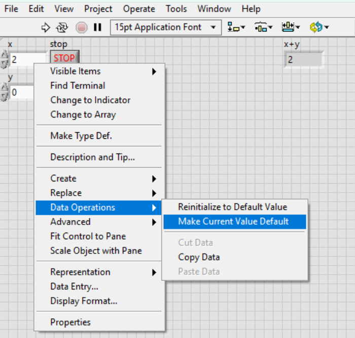

Context Menu: Use this method to set the default value of individual Controls or Indicators.
  1. Enter the desired default value.
  2. Right-click the Control or Indicator in the Front Panel or its Block Diagram Terminal.
  3. Select Data Operations > Make Current Value Default, as shown in the image below.
