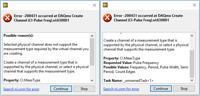

There are three new counter pulse measurements (listed in the table below) available in DAQmx 9.0 and later that are only
supported on X Series devices, 661x devices and newer cDAQ devices. If you attempt to create these tasks with unsupported hardware, you will receive the above error.
