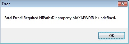

I am getting the following error "Fatal Error!! Required NIPathsDir property MAXAFWDIR is undefined." when I tried to install a NI software.
Why do I receive this error and how can I fix it?

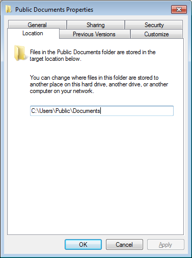

This error may occur if you move or delete the My Documents or My Picture folders on your computer. NI installers require the existence of both folders.
Make sure they both exist and verify the following points:
  • The folders can have different name or location.
  • They are on a different network location (which is not accessible at the installer runtime),
  • The folders do not exist.
You can fix the issue by assigning 'Documents' or 'Pictures' folders manually.
  1. Right-clicking on Documents from quick access menu or from the location of Documents folder and Select Properties.
  2. Go to Location tab and edit the Target folder location field and make sure that the paths to the folders are correctly
