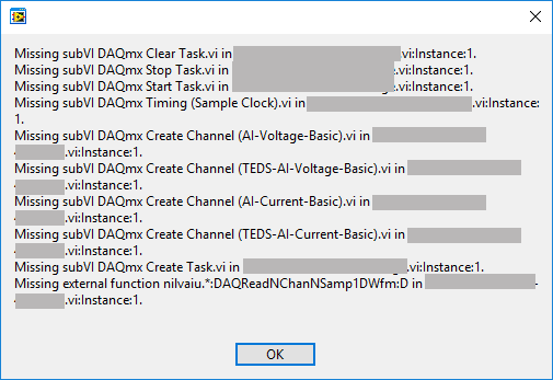

I am trying to run a data acquisition LabVIEW executable with DAQmx functionality on a deployment computer using a custom installer that I built in LabVIEW. After running the installer and opening the executable file I get the error below:
Missing subVI DAQmx xxxx.vi
How can I troubleshoot this issue?

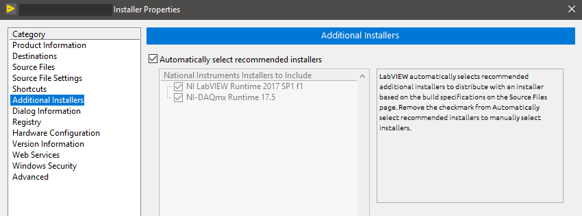

  • If you are deploying an installer, check to see that you have included all the drivers and toolkits needed to run the standalone LabVIEW application in the Additional Installers tab of the Installer Properties dialog box.
    • If you are only using basic LabVIEW and DAQmx functions in your VI, then you will need to include, at a minimum, the LabVIEW and NI-DAQmx Runtimes. In newer versions of LabVIEW there is an option for 'Automatically select recommended installers.' If you have one of these versions check to see if this is enabled.

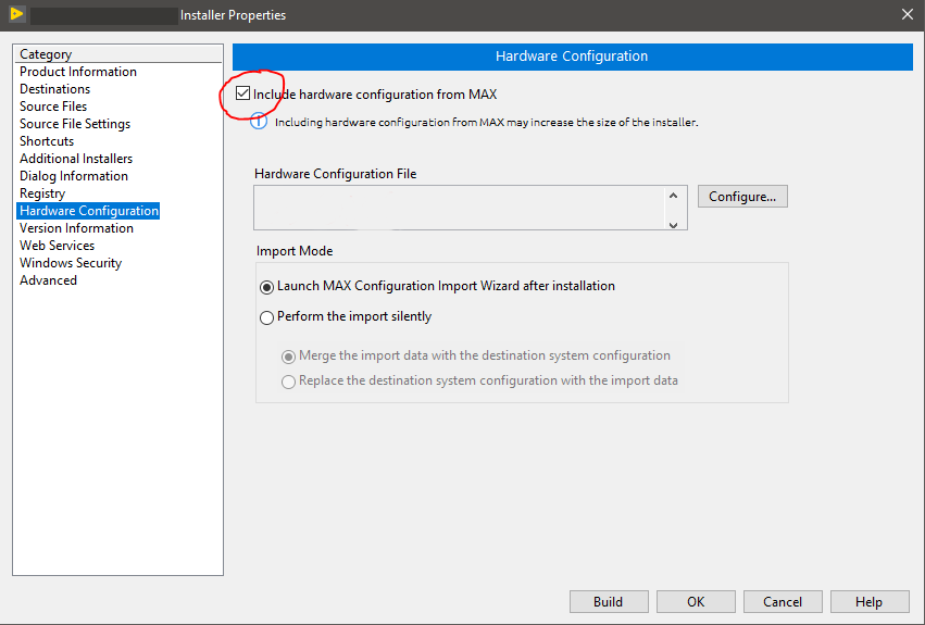

If your application incorporates custom hardware configurations that have been set up in NI MAX, check to see that they have been included in the installer, by going to the Hardware Configuration tab.
