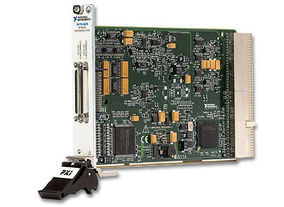

  1. A DAQ card must be in the last slot of the PXI portion of the chassis and have a full J2 connector at the end (see pictures in the Additional Information section below)
    • Since as all the SCXI communication is done through the backplane, ensure there is a full J2 connector on the DAQ card in the final PXI slot. The local PCI bus does the communication between the PXI and SCXI modules.

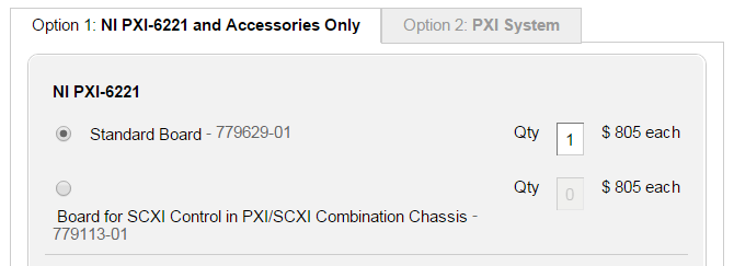

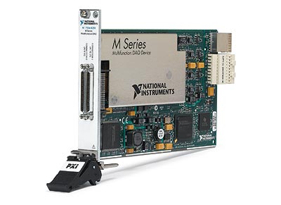

A PXI M Series DAQ card with a full backplane connector can control the SCXI portion of a PXI/SCXI Combination Chassis such as the PXI-1050, PXI-1052, or PXI-1010.  Most current M series cards are only shipped with hybrid Connector and cannot be used to control the SCXI portion of a PXI/SCXI Combination Chassis.  There are still some cards that are sold with the standard PXI connector option so that they can control the SCXI portion of a PXI/SCXI combination Chassis.  The devices sold now that will work with a PXI/SCXI Combination Chassis are:
  • PXI-6221 (P/N: 779113-01)
  • PXI-6229 (P/N: 779115-01)
  • PXI-6251 (P/N: 779117-01)
  • PXI-6259 (P/N: 779119-01)
  • PXI-6289 (P/N: 779123-01)
The respective M Series DAQ device will have two options under the pricing tab on the Product Page; Standard Board and Board for SCXI Control in PXI/SCXI Combination Chassis.  Select the latter for Combination Chassis control.

A PXI Card with a Standard Connector
A PXI Card with a Hybrid Connector
