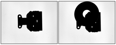

The object to detect is blocked by something else | ![](/servlet/rtaImage?eid=ka03q000001EEiy&feoid=00N0Z00000HEWRt&refid=0EM0Z000000FVos) |
