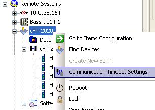

2. Right-click the name of the controller under Remote Systems and select
Find Devices.
![](/servlet/rtaImage?eid=ka0VU0000002vyH&feoid=00N0Z00000HEWRt&refid=0EM0Z000000FUmv)
3. Right-click the name of the controller again, and select
Communication Timeout Settings.

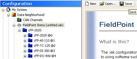

5. Highlight the iak file and click the
Save button as shown below.
![](/servlet/rtaImage?eid=ka0VU0000002vyH&feoid=00N0Z00000HEWRt&refid=0EM0Z000000FUnK)
