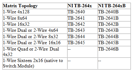

- Use front mount Terminal Block accessories (NI TB-264x and NI TB-264xB comparisons are handled later on in this documentation).

- NI PXI/PXIe-2532B uses equivalent TB-264xB accessories:

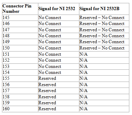

- A new custom terminal block is required to support the NI PXI/PXIe-2532B's improved connector.
- The following pinouts have changed:
