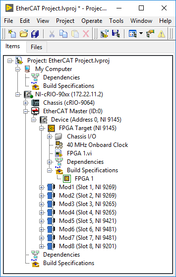

  4. Add and remove the modules you have in your LabVIEW project so that they match your hardware setup.
    1. To remove a module from the LabVIEW Project, right clicking the module, and selecting remove from project.
    2. To add a module, right click the EtherCAT device (NI 9144/9145) and select New>>C Series Modules…
  1. Deploy the target in the LabVIEW project by right clicking the CompactRIO target (cRIO) and selecting Deploy All.
  2. Recompile the NI 9144/9145's FPGA code using its build specifications, and download the FPGA bitfile to the devices.
