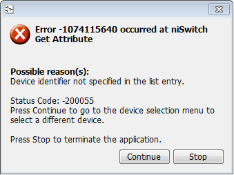

  • I am using the NI-SWITCH Connect Multiple VI in LabVIEW. This always produces error -1074115640. If I use the NI-SWITCH Connect Single VI, there is no error. Why is this happening?
  • I am using the NI-SWITCH API and I am running into the error below:
Error -1074115640 occurred at niSwitch Get Attribute
Possible reason(s):
Device identifier not specified in the list entry.
Status Code: -200055
Press Continue to go to the device selection menu to select a different device.
Press Stop to terminate the application.
This can occur when the device Name specified in NI Measurement & Automation Explorer (MAX) contains an invalid character such as a hyphen (-).
Removing this hyphen or invalid character will resolve this error. Refer to How Do I Find or Modify My Device's Name? for instructions.
