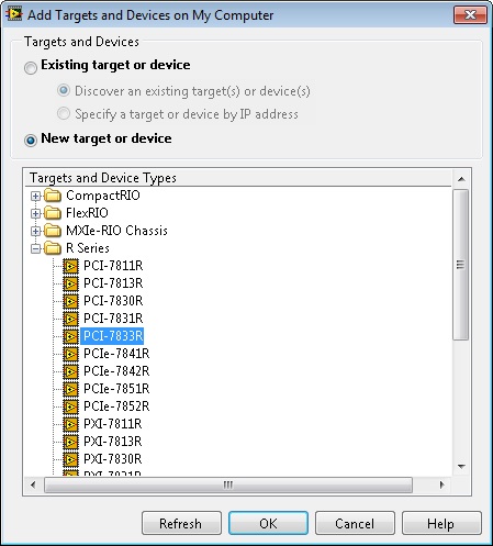

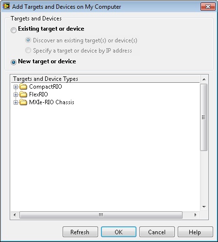

I want to add an R Series FPGA Target in my LabVIEW project's My Compter.
When I open the Add Targets and Devices on My Computer window, I can't see the R Series list, or I'm unable to see the Add Targets and Devices on My Computer option in the menu.
If you can't see the R Series targets and devices, it's because the NI R Series Multifunction RIO Driver is missing on your computer.
You need to:
  1. Close LabVIEW
  2. Download and install the NI R Series Multifunction RIO Driver compatible with your LabVIEW version
  3. Reboot the computer
  4. Re-open LabVIEW
The R Series will be listed now.
