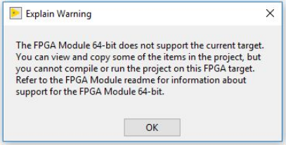

  • I want to use an FPGA Target on my hardware with the LabVIEW FPGA Module (64-bit). Is this supported?
  • My FPGA Target device driver installs LabVIEW 64-bit support, but when I try to add the module to a LabVIEW project, it doesn't appear in the list of available targets, though it appears in NI-MAX.
  • When I try to use the module, I get one of the following errors:
The FPGA Module 64-bit does not support the current target. You can view and copy some of the items in the project, but you cannot compile or run the project on this FPGA target. Refer to the FPGA Module readme for information about support for the FPGA Module 64-bit.
You have selected an item that cannot be created. Select another item to be added.
