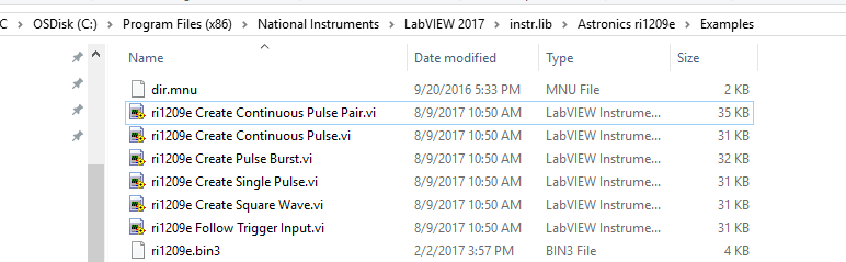

Where can I find shipping examples for the PXIe-1209, PXIe-2461 and PXIe-3352 Astronics devices?
  1. Install the LabVIEW instrument driver for your device. Refer to Related Links.
  2. When the process of installation is done, you can go to the following path where the shipping examples are: C:\Program Files (x86)\National Instruments\LabVIEW 2017\instr.lib\<Instrument Driver>\Examples. For example, if you chose the Astronics ri1209e driver, you'll see the examples shown in Figure 1.
Figure 1.

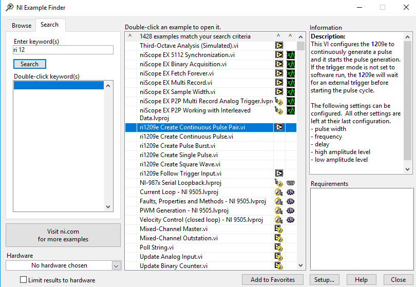

  1. On the NI Example Finder, you would find the examples as shown in the figure 2.
Figure 2.
