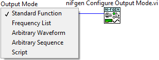

Because this waveform is defined as a Standard Waveform, Arbitrary Function Generator should still be configured with the Standard Function output mode when using the Configure Output Mode.vi

Some AWGs have DDS capability when in standard function mode, such as the NI 5441, NI 5442, NI 5450 and NI 5451. These AWGs, when programmed for Standard Function mode using the Configure Output Mode.vi, have all the benefits of DDS. Other AWGs such as NI 5412, NI 5421 and NI 5422 have a standard function mode that does not utilize DDS. These devices will generate a standard function that is loaded onto the board and generate them in the order that they are stored in memory, rather than specific samples from DDS. These devices are not ideal for applications where a standard function's frequency needs to change on the fly.
