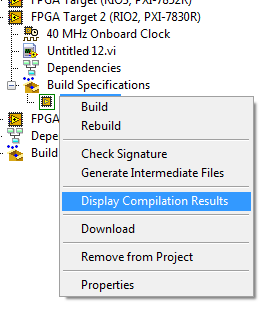

LabVIEW 2010 and Newer:

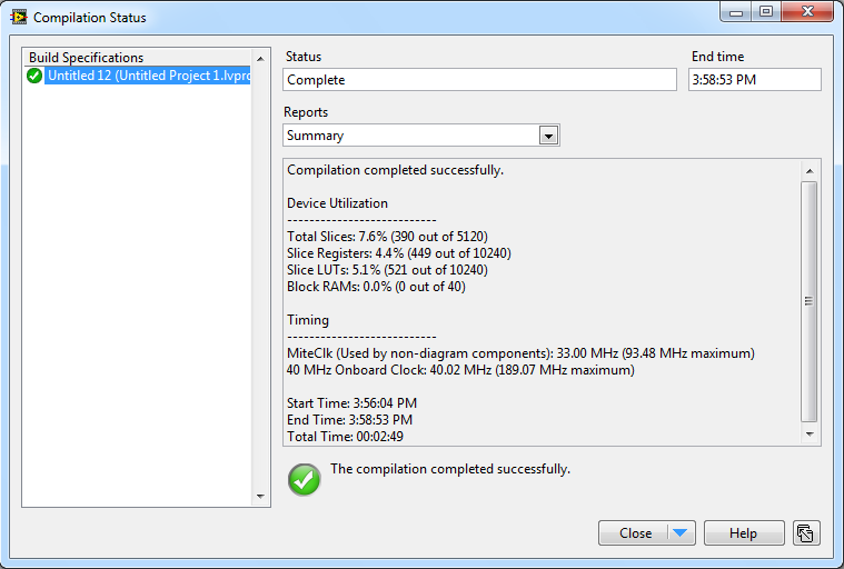

The addition of Build Specifications for LabVIEW FPGA VIs in LabVIEW 2010 has made it more convenient to access the results of the most recent compilation. To access these results, simply right-click on your FPGA VI's Build Specification and select Display Compilation Results.
Selecting this option will display the Compilation Status window for the latest compilation, successful or not. This status window also changed for LabVIEW 2010, with multiple reports for estimated and final device timing and utilization.
The log is also accessible at the following path. However, these logs are less formatted and more difficult to read.

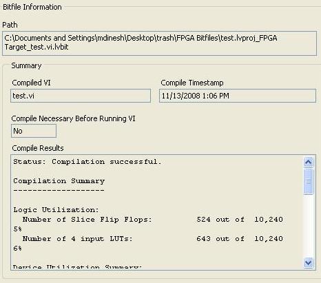

LabVIEW 2009 and Older:
To access the compilation logs, right-click the FPGA VI and select Target-Specific Properties. The properties window displays the latest compilation report details under Compile Results, as seen below.
