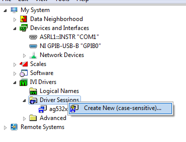

I am having trouble successfully initializing a driver session with the NI DC-Power Driver through C#. When I try I get the following exception:
"IVISessionFactory:  The specific driver’s main class (assembly qualified class name) is not specified in the configuration store.  Driver Session: niDCPower  Specific Driver (software module): NI-DCPower"

To create the driver session and logical name:
1. Right click the driver session drop down and choose “Create New”

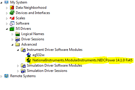

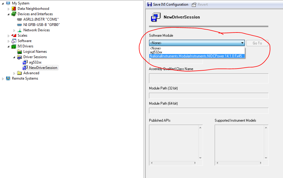

2. Select the Software tab and choose the Software Module for the version of .NET
3. Navigate to the hardware tab at the bottom of the screen and add the hardware resources you are going to use.
4. Save the driver session (top left >> Save IVI Configuration).

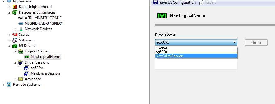

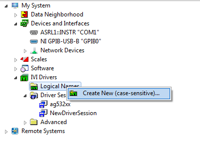

5. Create a new Logical Name (right click Logical Name drop down >> create new)  C
6. Configure it to point to the driver session you just created. It should populate in the drop-down menu.
7. Click Save IVI Configuration

If you have the .NET API installed successfully, you should see the following hierarchy showing the driver:
