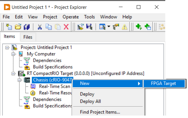

  • I am not able to add my FPGA target in Project Explorer.  When I right-click the chassis and select New>>FPGA Target, nothing happens. The FPGA target is not added.
  • My Real-Time (RT) target can't see the FPGA target in LabVIEW.
How can I fix this?

  • Be sure you are clicking the correct position in the LabVIEW project hierarchy to add your target. For example, if you try to add a cRIO's FPGA to the project while clicking under My Computer in the project, you will be unsuccessful. Refer to Adding FPGA Targets to a LabVIEW Project for detailed steps on adding an FPGA target.
