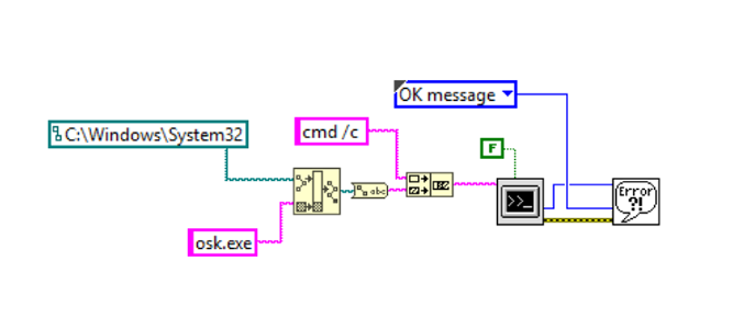

I need to programmatically launch Windows On-Screen Keyboard (OSK) application from my LabVIEW VI, thus I am using System Exec VI to call osk.exe, as shown below:
However, when running this VI on Windows 10 64-bit from LabVIEW 32-bit, either nothing happens with no error (and On-Screen Keyboard is not launched), or I am getting the following error:
Could not start On-Screen Keyboard
How can I fix this error?

Your LabVIEW code will be as displayed below:
LabVIEW controls are not native Windows controls and it is important to remember that LabVIEW is a cross-platform programming tool. As such, automatic controls such as maximising and minimizing of this keyboard executable will need additional actions to access the executable's run time position in the window. This may be possible through calling the API of the target executable however, this will vary between executables on whether this capability is available.
In case you are receiving an Error 2 (memory full) when using the System Exec VI in LabVIEW, you should execute the command prompt window first with the following command:
cmd /c
Thus, command line input of System Exec VI should be set to cmd /c  osk.exe
