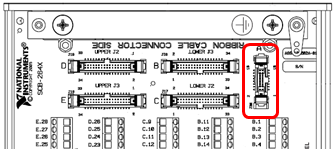

I am using the TB-2645 to configure the NI PXI-2532 as either a 2-wire 16x16 matrix or a Dual 1-wire 16x16 matrix. The TB-2645 only has headers to which I can connect ribbon cables. I want to access the individual lines of those ribbon cables by using the SCB-264x Screw Terminal Block. However, I have noticed that the TB-2645 has two 16 pin ribbon cables for the rows, but the SCB-264x has only one 16 pin ribbon connection available, as seen below. Therefore, I can only connect half of my rows at one time. How do I connect the two row ribbon cables of the TB-2645 to the SCB-264x Screw Terminal Block?
The TB-2645 and the SCB-264x are not compatible due to the fact that you will not be able to access the TB-2645's second row ribbon cable when using only one SCB-264x. If you are interested in using the TB-2645 to configure your PXI-2532’s topology, then the following options exist.
