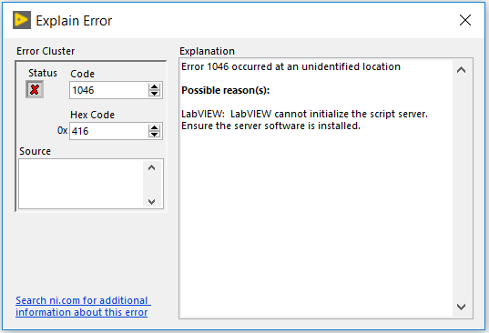

When I try to run a VI with a MathScript Node or a MATLAB script, LabVIEW displays the following error:
Error 1046 occurred at an unidentified location
Possible reasons(s):
LabVIEW: LabVIEW cannot initialize the script server. Ensure the server software is installed in concerned VI.

Licensing/Installation Error of MathScript Node
The error above may come from an improper installation of the LabVIEW MathScript Module or from not having the software activated.
  • Check that the LabVIEW MathScript Module is activated in NI License Manager.
  • Repair the LabVIEW MathScript Module with the NI Package Manager.
ActiveX Script server issues
This error may occur because the ActiveX script server did not start properly.
In order to reregister the ActiveX components, follow the steps below:
  1. Navigate to the MATLAB\(version)\bin directory (e.g., MATLAB\R2021a\bin).
  2. Open Windows PowerShell as administrator.
  3. Enter matlab -regserver at the prompt and hit Enter.
  4. Quit the instance of the MATLAB® software that appears.
Use of MATLAB script without MATLAB
This error can also occur if the LabVIEW VI tries to call a MATLAB script node when MATLAB version 6.5 or later is not installed or not properly activated on the computer. This is because the MATLAB script nodes invoke the MATLAB software script server to execute scripts written in the MATLAB syntax.
Note: Ensure that MATLAB is installed on the same local disk where LabVIEW is installed.
