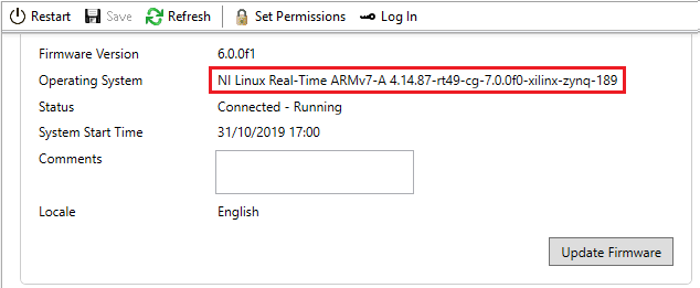

5.  Format the hard drive by using one of the following commands based on the ELVIS III operating system, as seen below:
           For ARM-based (32-bit) targets:
     nisystemformat -f -t ubifs
     nisystemformat -f -c -t ubifs
     reboot
           For Intel-based (64-bit) targets:
     nisystemformat -f -t ext4
     nisystemformat -f -t ext4 -c
     reboot
