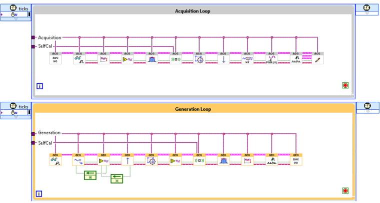

FPGA Block Diagram
VST FPGA Acquisition and Generation
If the request is accepted, the user will be provided with a detailed document explaining the hardware setup, software setup, required driver files, procedure and caveats to allow FPGA customizations. The instrument driver FPGA source code is the starting point for creating your own instrument driver FPGA extensions.
