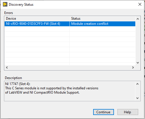

Due to an error in the new
Module Development Kit for the 904x and 905x cRIO series, an autodetection is currently not possible.
To use the module, please add the module manually without the autodetection feature:

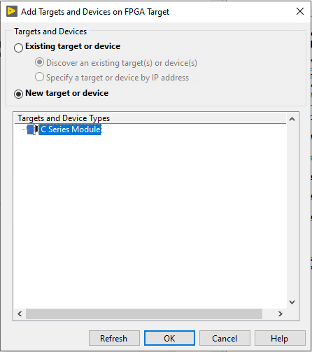

2.Choose
New target or device >> C Series Module >> Ok![](/servlet/rtaImage?eid=ka03q000000lPLv&feoid=00N0Z00000HEWRt&refid=0EM3q000001BPRf)

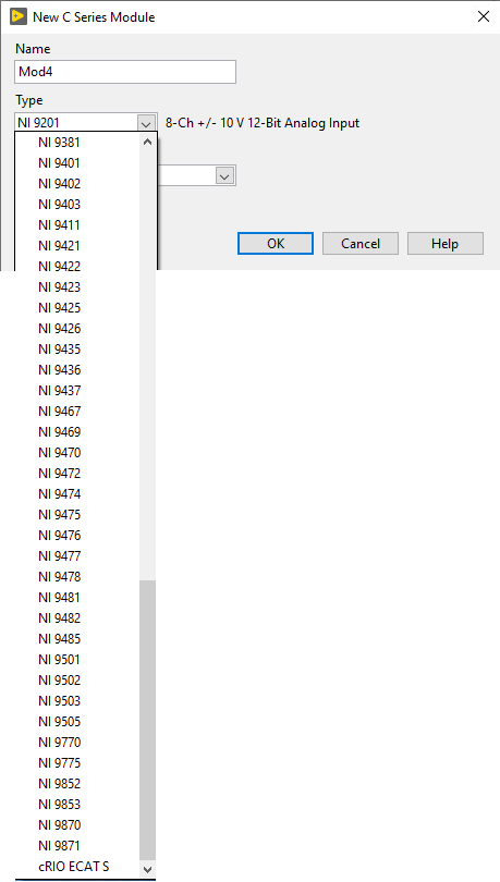

3. Choose
cRIO ECAT S of the Type drop down menu and choose the right slot in your cRIO chassis.
![](/servlet/rtaImage?eid=ka03q000000lPLv&feoid=00N0Z00000HEWRt&refid=0EM3q000001BPRu)
After the module is added manually to the correct slot, you can use the module as usual.
