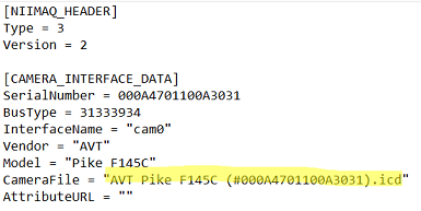

For example, with the .icd file names as  'AVT Pike F145C (#000A4701100A3031).icd', a correct .iid files will show the next information:

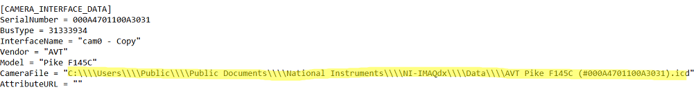

A wrong .iid will show the next information:
