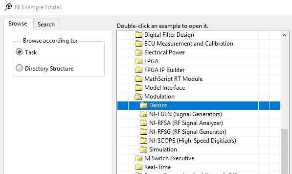

You can find NI LVMT built-in examples from LabVIEW:
  1. Clicking on menu Help>>Find Examples.
  2. From NI Example Finder window, navigate to folders Toolkit and Modules>> Modulation
