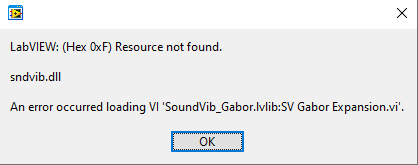

  • When I build and run an executable using the LabVIEW Sound and Vibration Toolkit, I get the following error message:
LabVIEW: (Hex 0xF)Resource not found.
sndvib.dll
An error occured loading VI <name>.vi
Missing external function sndvib.dll:<function> in VI <name>.vi
This is a known issue. As a workaround, kindly perform the following steps:

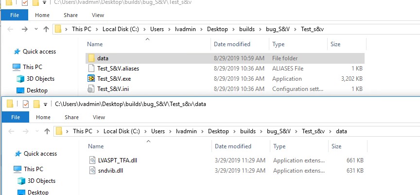

  1. Search for LVASPT_TFA.dll. The file is located in the following path depending on the version of LabVIEW installed.
  • C:\Program Files\National Instruments\LabVIEW 20xx\resource
  • C:\Program Files (x86)\National Instruments\LabVIEW 20xx\resource
  1. Copy LVASPT_TFA.dll into the Data folder of the executable.
    • In other way, LVASPT_TFA.dll can be included in "Always Included" when creating executable.
3. After this, you can run the application.
