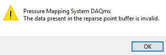

Error: The Data Present in the Reparse Point Buffer Is Invalid
Updated Aug 22, 2019
My LabVIEW project is missing VIs saved in an llb. When I go to select the missing VIs in their saved location, I get an error message that says "The data present in the reparse point buffer is invalid."
1. Check to ensure the llb contains the VIs you are expecting.
2. If the files are missing from the llb, navigate to the %temp% folder on your computer to see if the files have been saved there.
3. If the files have been recovered, save the files in the original llb and select them appropriately.
