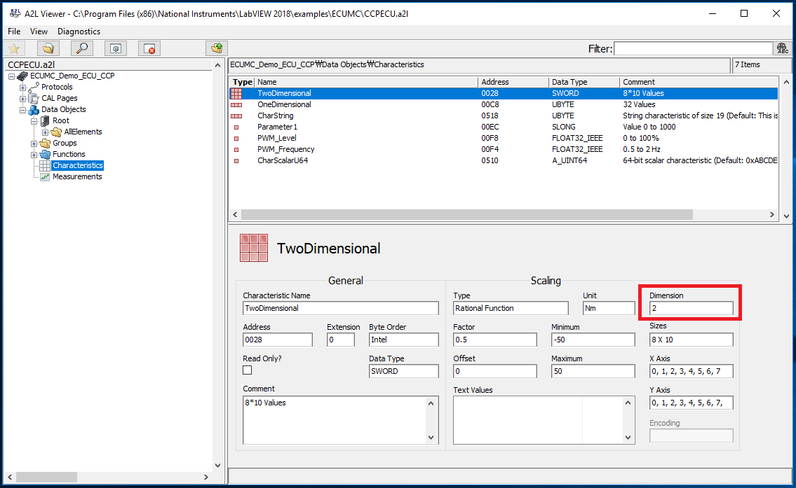

You can read multidimensional data with
MC Characteristic Read.vi because
Characteristics contains multidimensional data.
You can see below that two-dimensional data is in
Characteristics. ![](/servlet/rtaImage?eid=ka03q000000t9sR&feoid=00N0Z00000HEWRM&refid=0EM0Z000000phFd)
