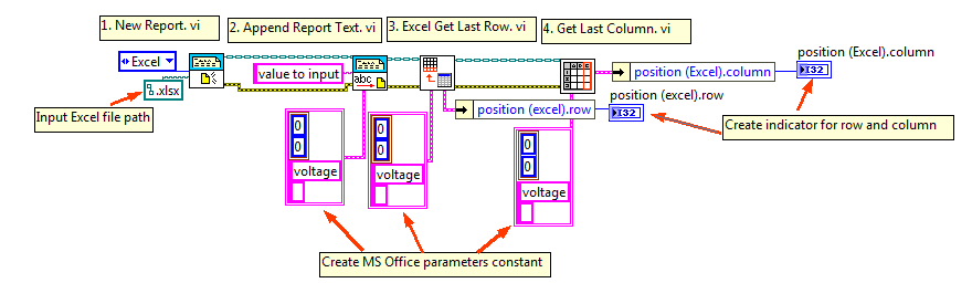

  3. Implementation using LabVIEW Report Generation Toolkit:
  • Input Excel file path in template input terminal of New Report.vi .
  • Use Append Report Text.vi to input value to specified cell. Leave the input blank if you do not need to input anything.
  • Wire the Excel Get Last Row.vi and Get Last Column.vi as shown. In the MS Office Parameters input, right click to create constant and enter the cell name. In this example, the custom cell name is voltage. Wire MS Office Parameters out to an unbundle by name function and create an indicator to output the row and column index respectively. For more information on MS Office Parameters, refer to the LabVIEW Help file or the description in Excel Get Last Row.vi

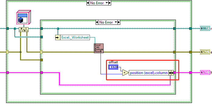

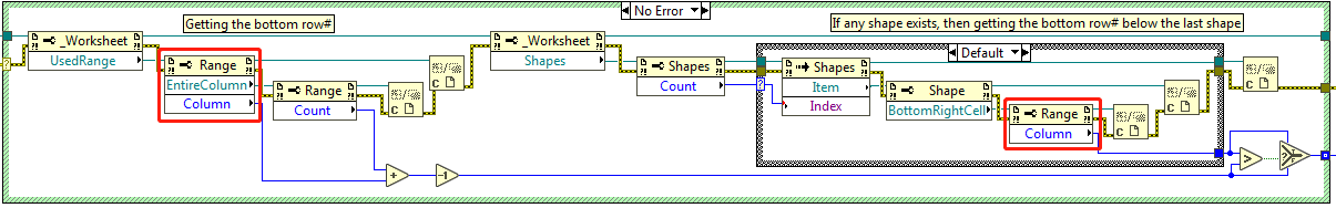

  1. Double click the Excel Calc Bottom Row# subVI in Excel Get Last Row.vi to make the following modifications marked in the red square. Click on the small black arrow to expand the list of options available.
2. In Excel Get Last Row.vi , modify the following:
