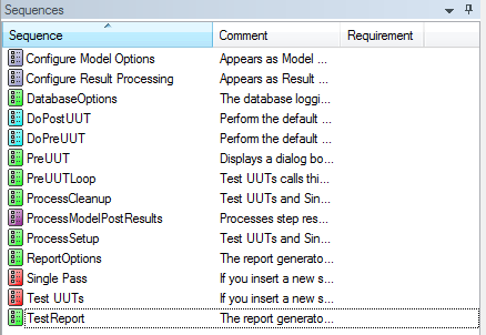

In the sequences pane in TestStand, I can see that each sequence has a different color associated with it. What do these colors mean?
Sequence colors are used to represent the sequence type. Below is a short guide on what each color represents:
ColourSequence Type
RedExecution Entry Point (only available in Process Models)
PurpleConfiguration Entry Point (only available in Process Models)
Green Process Model Callback
BlueStandard Subsequence
Dark PurpleEngine Callback
For more information on these sequence types, refer to chapter 10 of the TestStand Reference Manual, which is included in the Related Links below.
